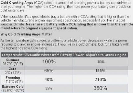

Even With a new fully charged Battery at -17.8C you only have 40% of the original CCA available and it takes 210% to start.
This is why you need a good fresh battery with clean & tight terminals rated at 800CCA + in Winnipeg.

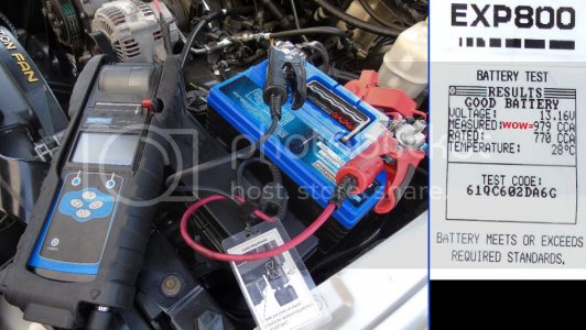

This Motormaster Ultra made by Exide, I paid $179+tx for and is rated at 770CCA yet on a $3000 Midtronics load tester can crank 979 CCA!!

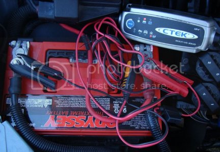

I have to say that overall I am very happy with Kj's charging system!
With the Flat plate AGM from scan gauge, reports 14.9 most of the time when I first fire it up, and settles down to around 14.6v overall.
Once a month for general battery maintenance, I still like to manually trickle charge the batteries.
Short trips, frequent starts, don't really cut it for proper charging.
Yesterday I charged the sedan overnight.
54771[/ATTACH]"]
It definitely liked the 14.7v output from the C-Tek !!
