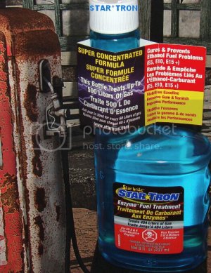

Ethanol fuels are a magnet to moisture. Water in fuel could cause misfire.
Try some of this quality stuff, at Walmart...
"Helps prevent phase separation by dispersing water throughout fuel as submicron-sized droplets that are safely eliminated while the engine operates"
53819[/ATTACH]"]
Link about Starbrite-Star Tron: Star Tron Enzyme Fuel Treatment Gas Additive Small Engine
