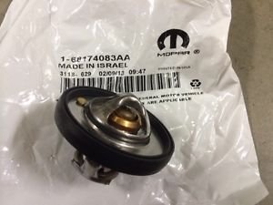

Welcome to the forums.
HOAT or Zerex G-05 coolant only for our Jeeps. Has any other coolant types ever been added before?
Code 0128 is directly related to the thermostat.
Probably best to drain the system & install a new Mopar Thermostat.
Coolant temps can be read by scan tools, if stuck open, too long to warm up, it will set this code.
Further info can be found in Factory Service Manual. What year of KJ do you have?

Green coolant not good. Best flush is...Find a shop that has a pressurized coolant re-circulating machine. (dealers often have one)
Ensure that Hoat coolant or Zerex G-05 only is used.
Air is something that can be bled out at top rad hose hex.
Installing the Mopar thermostat should solve your issue as it has it's own air bleed also built into the thermostat.

With green coolant in core it's bad news. You want to remove everything and replace it.. & the only way to do it right is with a re-circulation machine.
The green coolant does not mix well with Hoat and it causes a gel like substance/coagulates and can cause water pump, broken plastic impellers.
Keep in mind in a proper mixture it includes distilled water, not good ever to flush with tap water.

Make absolutely sure they use the Mopar thermostat part, which is # 68174083AA.
