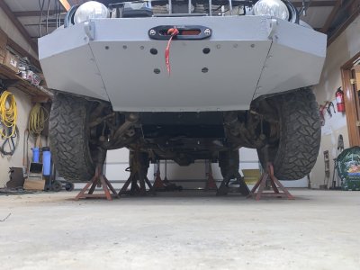

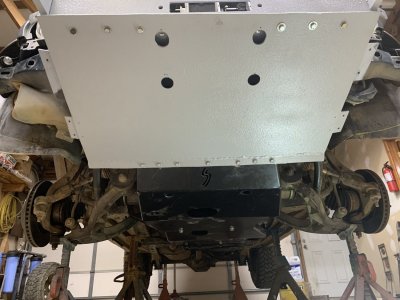

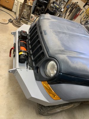

Couldn't find a decent winch bumper and front skid plate that covers the washer bottle and lower radiator&condenser coil
Made my own.
Uses a 5/8 strap from hook mount to front bolt for front diff assy. The hollow "frame" rail is way to light weight.
Then used Skidrow skid plats back. Had to install 3/8 rivnuts in the crossmembers for trans plate.
