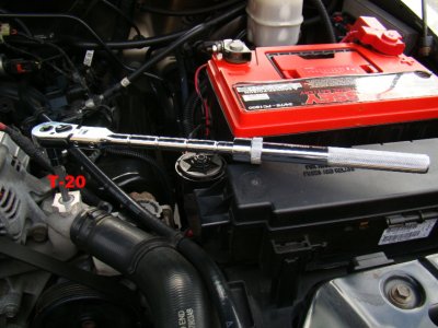

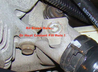

Ya the Jeep definitely needs Hoat or Zerex G-05 only. Did you use a Mopar 195 degree thermostat?
Once cold overnight, see if the coolant is at or below the cold line on reservoir tank. If it's low, add some back to cold line. (May have to repeat a few days)
To get air out, slightly crack the air bleeder slightly open when HOT-- til no bubbles are seen, then close it. see images below.
Use the correct tool to break it free, air bleeder hex, located at top rad hose. Keep centered and use downward force to break it free, don't strip it.
You can also cold fill at bleeder with a small funnel initially.
Use the correct tool to break free the air bleeder hex, located at top rad hose.
You can also cold fill from there with a small funnel initially.
