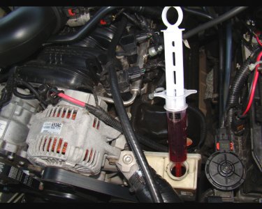

Hi everyone
I’m looking for advice/info etc on a new whine noise coming from the front end of my 2005 Jeep Cherokee KJ (v6 auto, petrol).
It’s worst when turning and at slow speed.
I’ve changed the power steering fluid but no real difference in sounds… no leaks detected.
Help please, I’ve already done so much to restore my gorgeous beast, don’t want to miss anything that will stuff it up!
Cheers

Did you use ATF+4 transmission fluid as recommended in the owners manual ? Or actual power steering fluid?
Sometimes when air enters into the system through a fine pin hole (barely noticeable) in power steering lines, it can be a bit noisy.
What you can try is getting both front wheels off the ground, and then turn wheels back & forth to eliminate air.

Yeah you definitely need ATF+4 fluid in the 2005 KJ!
The 2002 KJs came from the Factory with Mopar Steering Fluid fitted...a slightly Honey Colored fluid.
They then brought out a TSB that these 2002 models need to have the fluid completely drained and then filled with red ATF+4 by the Dealers.

Thanks LibertyTC and BillWill! I foolishly listened to the auto shop person who was adamant I should use readily available power steering fluid… I’ve just got home from different supplier with the correct drainage tool (thanks for the pic!) and the closest thing to ATF+4 which was the Castro TransMax multi vehicle

Woh...Dexron III- it's way outdated & not even a full synthetic !! Dexron VI is the current GM fluid !
Do a google search from your browser, there surely must be ATF+4 somewhere IN AU.
