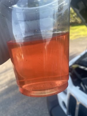

I saw this 2007 3.7 with 81 k for sale today. Looked pretty decent however this coolant tank has me concerned. Seems to have particulate inside. Wish I could have gotten better photos. Oil did not appear to have coolant inside. Thanks for any advice

I see the fine particulate, with some of it floating.
My question is did someone potentially add some pepper, as a stop gap measure to fix a leak in system at some point ?
The Jeep's coolant could use a good flush by the looks of it.
Inquire at a Jeep dealer to see if they have a "Pressurized coolant re-circulating machine"
This service is the best method of removing all the old coolant and restoring it to completely new HOAT coolant.
This would also be a good time to replace the thermostat (Mopar Only) & hoses if necessary.
The only type of coolant for our Jeep's should be "Mopar Hoat" or "Zerex-G05" ONLY !!!!

I have seen people add pepper before but this doesn’t appear to be pepper material. Does anyone think this is really a major issue or just needs a flush? It’s got me
hinging on whether to purchase the Jeep or not. It’s also a little strange the Jeep has only been driven 175 miles in 2 years. No engine codes and passed NC inspection in 2020.
Thanks again

No engine codes is good, have you test drove the Jeep?
15 year old jeep averaging about 5400 k miles per year.
Is this a dealer sale or private, any history of maintenance?
Any rust ?
Flush with Hoat & you should be fine..
