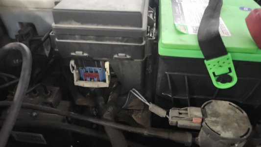

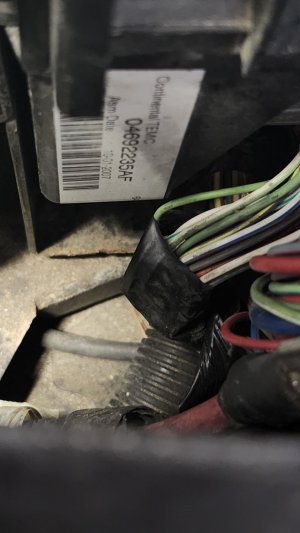

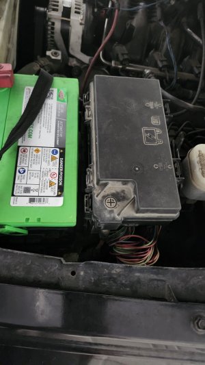

I broke down a few weeks ago and the repair shop replaced the ICM. 2 weeks later I'm having mis fire in cylinder 1 first crank doesn't start. Second or 3 does and only cold starts. Also I questioning if they installed a new one. (My fault for not looking under the hood after the repair) but a brand new unit ordered from the dealer should not be dusty and have dated 10/2007 on the serial number tag. I called another dealer to run the serial number and they told me the unit was activated in 2008. BTW I bought it brand new in 08. Thoughts on my mis fire. I tried to disconnect the coil and swap 1 and 2 but couldn't get the damn clips off. The repair shop is 90 miles away and right now im not sure I can trust them. see picks.
