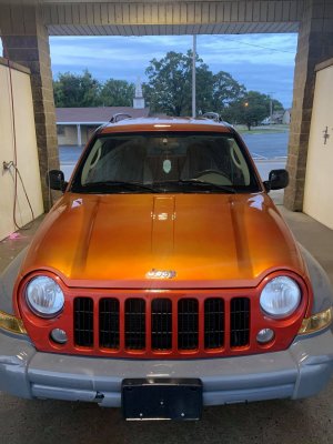

well we have a liberty sport i am thing 2 inch lift and wheel spacers and i am not sure where to start looking i live in Oklahoma and the liberty is hated around here and the jeep community is not showing any love so where do i start oh we drive it Daley and i want to hit some trails any help will be apricated thanks on it is stock as of now

OME 927 front and OME 948 rear springs
Bilstein shocks in front are the same ones for stock
Bilstein rear are ones from 99-04 Dodge Dakota CLUB CAB 4X4
Bolt down 2 per side hockey pucks to the lower spring perch in rear for extended bumpstops
Teraflex makes extended front bumpstops
I daily drove my 4.5 inch lifted ( my 04 ) with 32s etc for over 9 years and 232,000 miles before she was semi retired
now my 03 with 2.5 inch lift, 31s and 4.10 gearing is daily driver
lifting them the right way makes them way better handling and also ride is way better than new stock

Is that orange, or is it the lighting throwing me off?, anyway, looks nice. Go the OME route like Tom suggests, you'll be happy.

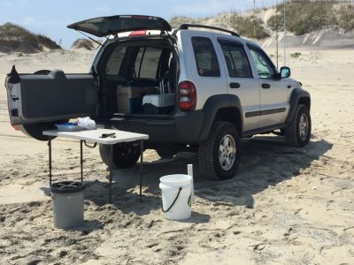

I installed 2.5 inch lift and 2 inch wheel spacer from Rock Road Outfitter's https://www.rocky-road.com/liberty.html. Fairly easy install for a kit made for the 2003 Liberty CRD.

I installed it over 4 years ago and have had no issues so far. RRO has been great with the customer service and any assistance I needed.
One of the very very few lucky ones I guess
If they were the very last place to buy lift parts for me or my customers, I would have to go stock
Ripped off too many people over the years and sold bad parts
