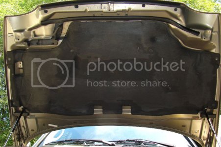

Possibly mine is past cleaning..?? If I even touch it, all I get is dust coming down..eeek...
50050[/ATTACH]"]
This is causing small particles to stick and cover the top of alternator making it look corroded. Dealer want $108 for a new liner..still available + the plastic clips.
I am thinking a trim shop my be able to cover it with new material that would be washable, which would be great!.

Hood Liner Now Clean!
Ok it was a bit of work to clean the hood liner here is what just took place...
50075[/ATTACH]"]
At power wash facility with a heavy duty vacuum..I carefully Vacuumed the liner...
Then into hand power wash bay, soaked the hood liner carefully not too close.
Then once wet, I used car wash soap and rubbed in by hand all over the soap.
Then rinsed out the soap/power wash again. To get water out, hands used to push water down/off the liner.
Then Re-Vacuumed all the remaining water out of liner to let dry.
Looking much better ... more time needed to dry...
50077[/ATTACH]"]
Once dry I may paint it black to make it perfect...But it is ok for now... :waytogo:
