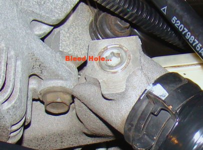

It could also be trapped air in system, can take a few days, use bleed screw,top rad hose housing.
When Hot, slightly loosen till air bubbles come out with coolant, and close it.
I place paper towels below, before I opened it.

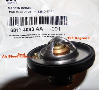

Note the Mopar thermostat has a air bleed hole which helps, did you use the Mopar one?

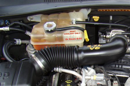

I assume you only used HOAT or Zerex G-05 for coolant if not, flush time again!
