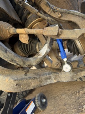

My 2007 Liberty has 140 K ish miles. Had original shocks all the way around. Replaced them with NAPA shocks and struts. Installed, torqued everything. Even replaced and torqued the front sway bar bushings. Upper control arms were replaced by shop couple years back. Only thing I didn't do was replace the sway bar links.
Open both the drivers side and passenger side doors. Jump on door jams. Sounds good/drives fine till I go over a speed bump. Slow speed and I hear noise out of right front end. Clunk noise is best description.
So my thoughts are sway bar links or bad shock or ball joint failing.
Other ideas, thoughts appreciated.

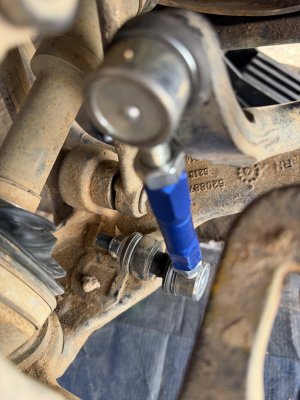

TY for feedback. Yesterday I replaced the front brake calipers and rotors. Clunk side rotor was worn vs the driver side. Also replaced the sway bar links. Will need to bleed brakes to test drive. Will post results soon.
