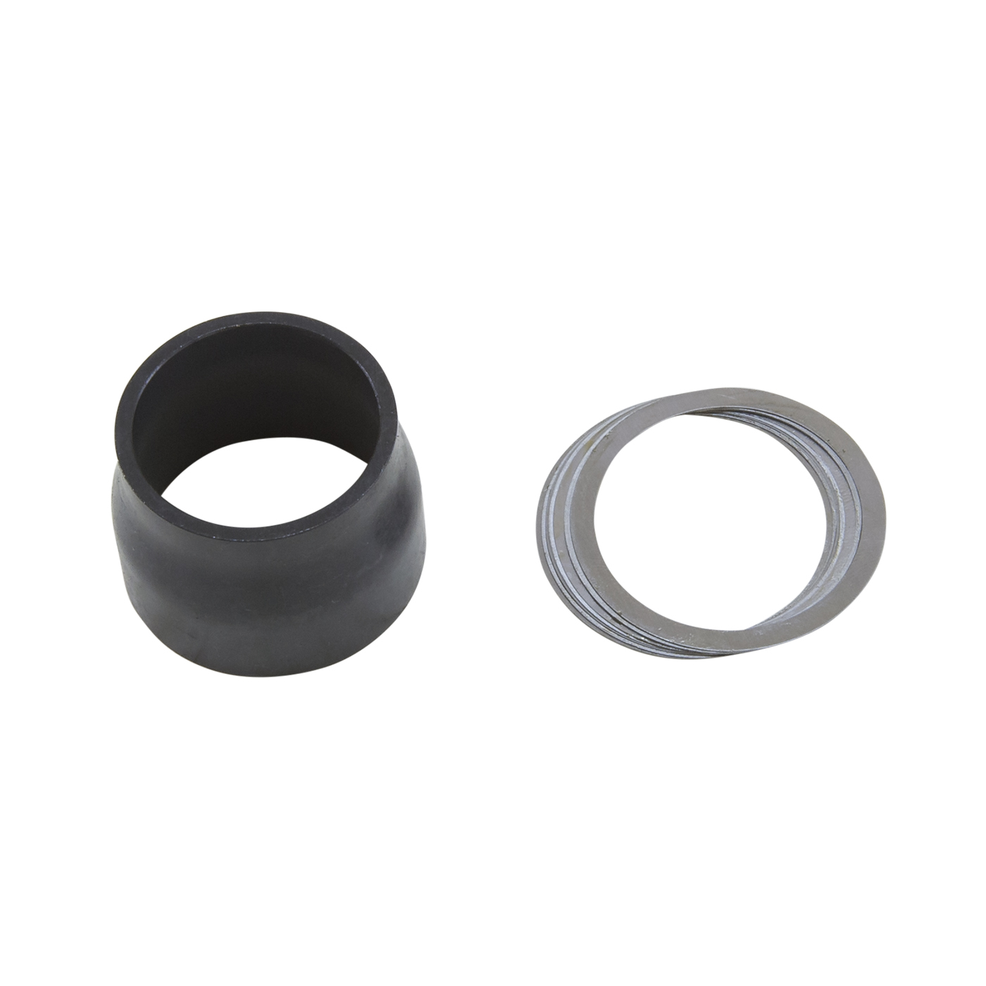

I don't have the answer, but I got crush-sleeve eliminators instead. I don't have the experience or confidence to get this stuff right the first time.
The super 30 crush sleeve (and eliminator) is shared with a few other diffs - maybe it's the JK/KK D30. I'm away from home so I can't check what I got.

If you install a crush sleeve eliminator kit, then the torque on the nut becomes relevant. It is a nice upgrade, but if you do the install correctly, the crush sleeve performs just fine.

If it was sourced from somewhere reputable and it seems "weak", the eliminator kit would be the way to go. Good luck

Sorry, did not mean it felt weak. Just meant it did not look like it would take double the torque to crush as the one in the rear 8.25 axle. Appreciate your help and info. I have an eliminator kit for my 2008 JK with a Dana 30 in it that I have not installed yet. I will have to check and see if it is compatible with the KJ. I am pretty sure the crush sleeves are the same part number.
