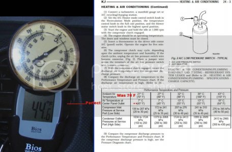

9,098
Here is the drivers side vent air temp specs, Jeep is not the coldest A/C on the block:
58963[/ATTACH]"]
& this is where the low/high side values should be.
58965[/ATTACH]"]

I have a meat thermometer somewhere in the house... I'll have to find it. 45?! Geez! I'd take it!
