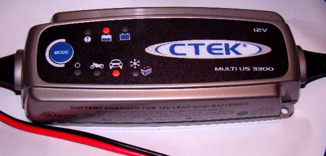

Since you Kj sits 5/7th's of a week, you could connect this 3.3amp small intelligent charger (CAN TIRE) with ring terminals and it can be left on 24/7 and is water & temp proof.

Until I find one I chose to buy an intelligent battery charger;
My old battery charger was a "dumb" model. Simply a bridge rectifier & an amp meter.
